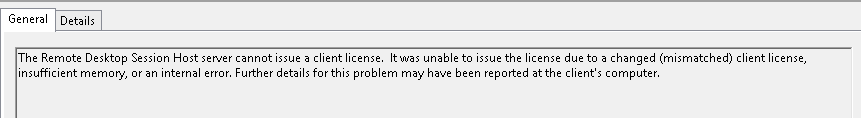

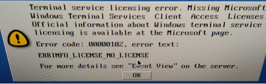

I have encounter the error again, when I use Device CAL WTware is generating error that license error.
When I use a windows PC the Device CAL license was issue without a problem.
I have read up that a device require to store a hardware certificate on the device it self is that missing on WTware software?
WTware error - license_error_wtware2
Windows Server error - RDS_Device_CAL license_Error

- RDS_Device_CAL_License_Error.png (4.24 KiB) Viewed 25879 times
- license_error_wtware2.png (190.52 KiB) Viewed 25879 times
Re: RDS Devices CAL error with WTware
http://wtware.com/logs.html
Please, save the log when you see error message on client screen. Not after client reboot. Not from another client.
