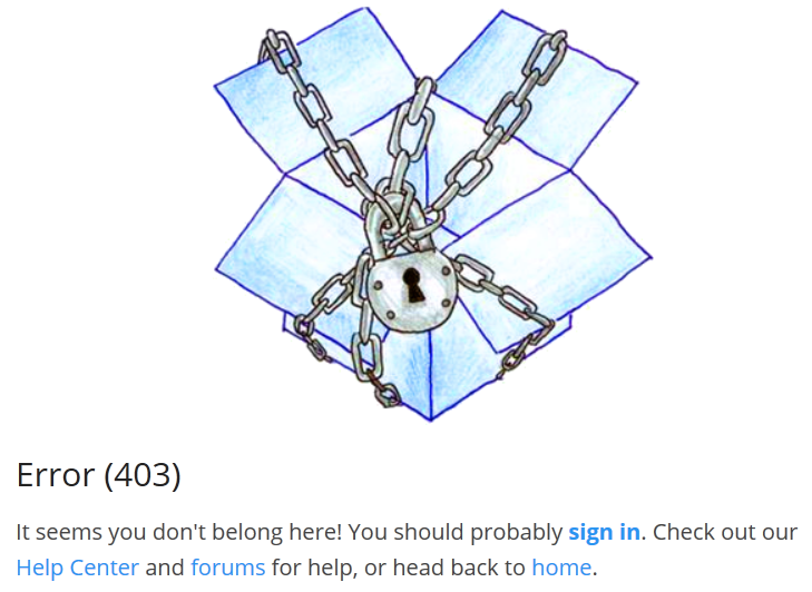

Re: menu.gif and keyboard issues
Do you want to see your image on this screen?
P.S. Here is what Dropbox shows me when I try to open your image:
