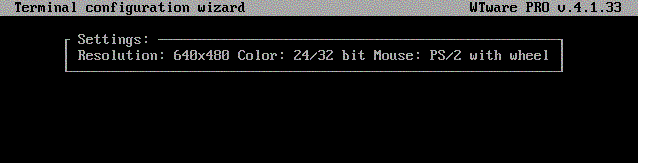

I changed all the components on my Terminal Client - Motherboard, processor, CD ROM ...everything. Its a new client now.
Boot Method on Client - Boot from CDROM
After this change , the Terminal Client boots up correctly using the same CD which I was using with Old hardware..
Problem is - It gets stuck on the attached screen and I am not getting below options at bottom:
F1-Help F4-Edit Settings F10-Create Configuration
I deleted the xx.xx.xx.. .wtc and xx.xx.xx.... .graphic file from this location on Terminal server: C:\Program Files\WTware\TFTPDROOT\PRO\4.1.32\configs\
So there are just 2 files now - 00.00.00.00.graphic and wizard.wtc.
As per my understanding, I should get the new Configuration wizard when I boot Terminal Client, however it's getting stuck and not giving any option to create new Configuration. Also other files should get created automatically in C:\Program Files\WTware\TFTPDROOT\PRO\4.1.32\configs\ which is not getting created.
Please help!!!
Nikhil
Re: Create New Terminal Configuration...
It looks like wtware error. Sorry, I cannot fix any errors in 4.1.33. Please, try fresh version, 4.4.21 (or 4.5.36 you run it on new hardware).
