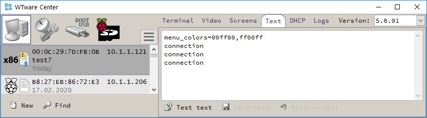

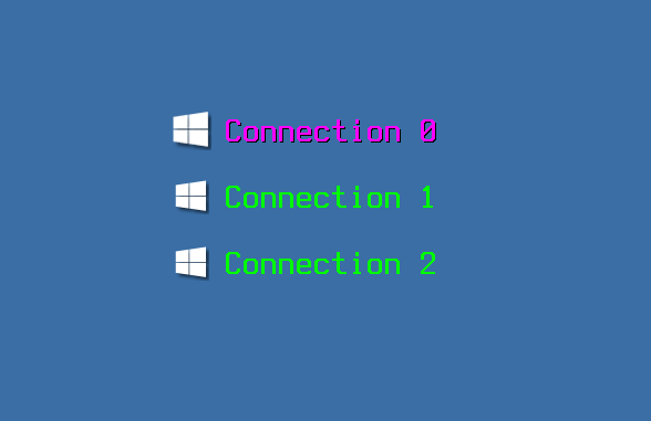

Please try this:
http://wtware.com/testing/202002220938.zip
In config:
menu_colors=00ff00,ff0000
Re: Change the font color?
Sorry, I didn't test configurator :(
Write value in "Text" tab. It will display errors, but save config.

nicktheclick wrote: Mon Mar 16, 2020 6:43 pm I'm using WTware 5.8.90...having problems with this parameter.
Because it's in 5.8.91. Use the link above or today's build: http://wtware.com/testing/202003161523.zip

Works just perfect !!!
Thanks !!
