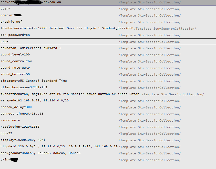

3) Have you had any luck with a configuration for redirected sound via the audio jack to limit delay\lag? when viewing youtube videos in a small window I have managed to get it to view loseless video at 30fps and sound is in sync however after 30 seconds it can get out of sync, sometimes there is crackling also.
config is attached as wtware conf.PNG.

Sound buffer is at 50, sound_rate is 44100 with sound_control=hw.
akatik, when I select sound_level=50 (assume you mean 50 not 5) it basically sets the max volume at 50%, a new RDP session will connect with Windows sound set at 100% however it's only half the volume. I realise now this is a RDP thing and not much you can do. I have set the volume at 75 and now volume is high but not super loud in class!
