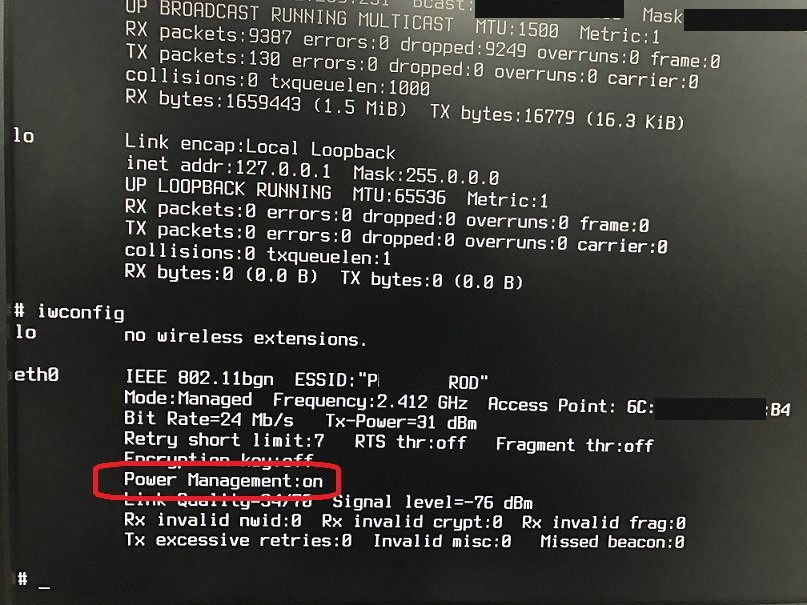

Hi Aka,
Thanks again, the wireless authentication is now working, but I hit another issue that it will turn off by itself when the rpi session is idling
I have do some read out and this could the potential cause:
http://raspberrypi.stackexchange.com/qu ... nt-setting
1. Upgrade the wireless firmware
sudo BRANCH=next rpi-update
2. Turn off power management.
sudo iwconfig wlan0 power off
Can this be integrate to WTware?
Again your help is very much appreciated.
Additional link info:
It also mention on the be link that it will improve the wireless self turn off and performance issue.
https://www.raspberrypi.org/forums/view ... 7&p=924657
Thanks,
Ken
Turning off wireless power management
- iwconfig.jpg (200.25 KiB) Viewed 13776 times
Re: Turning off wireless power management
Please try: http://pxe.ru/files/testing/201611181321.zip
You can see iwconfig output on embedded web server.
