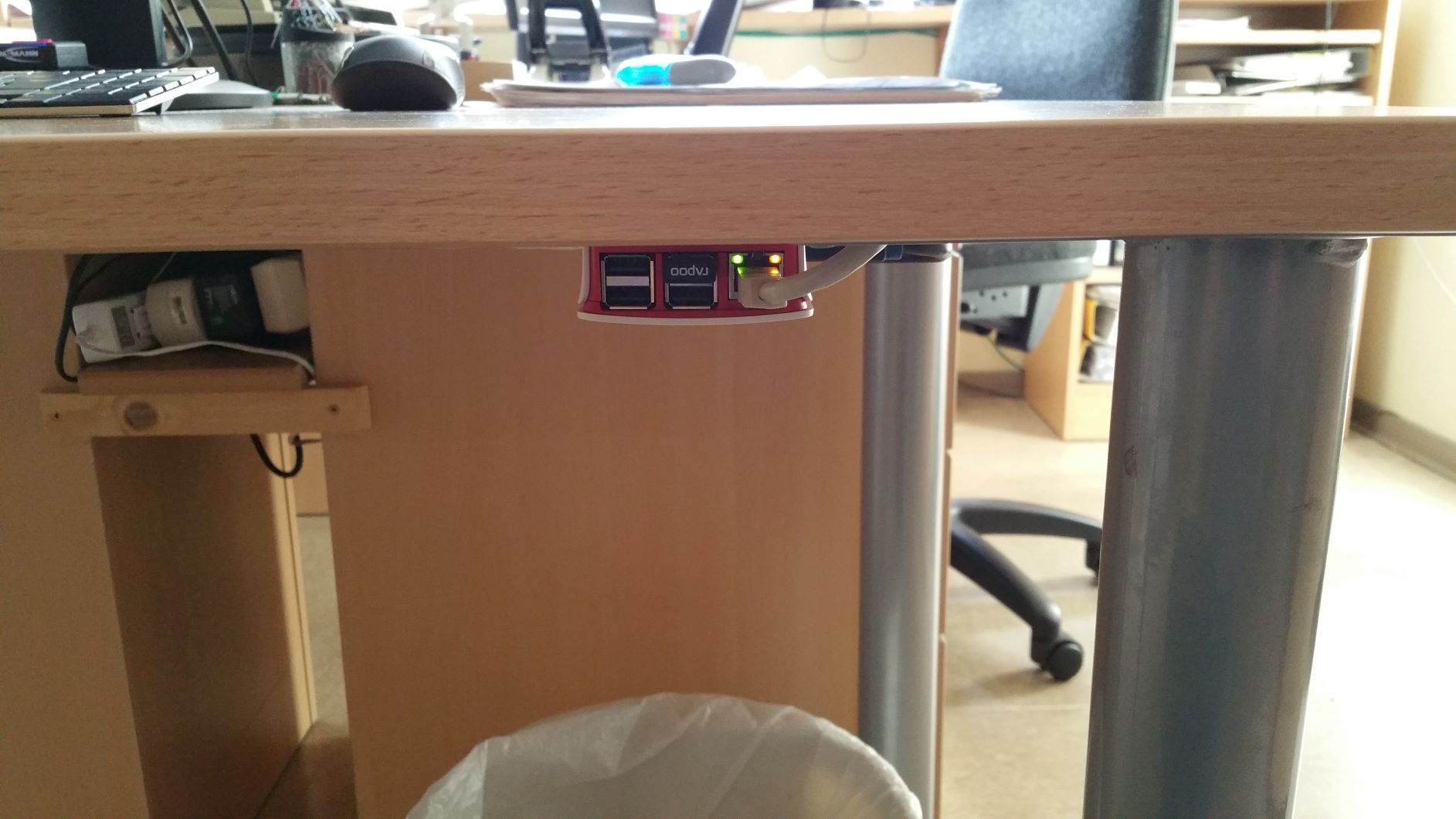

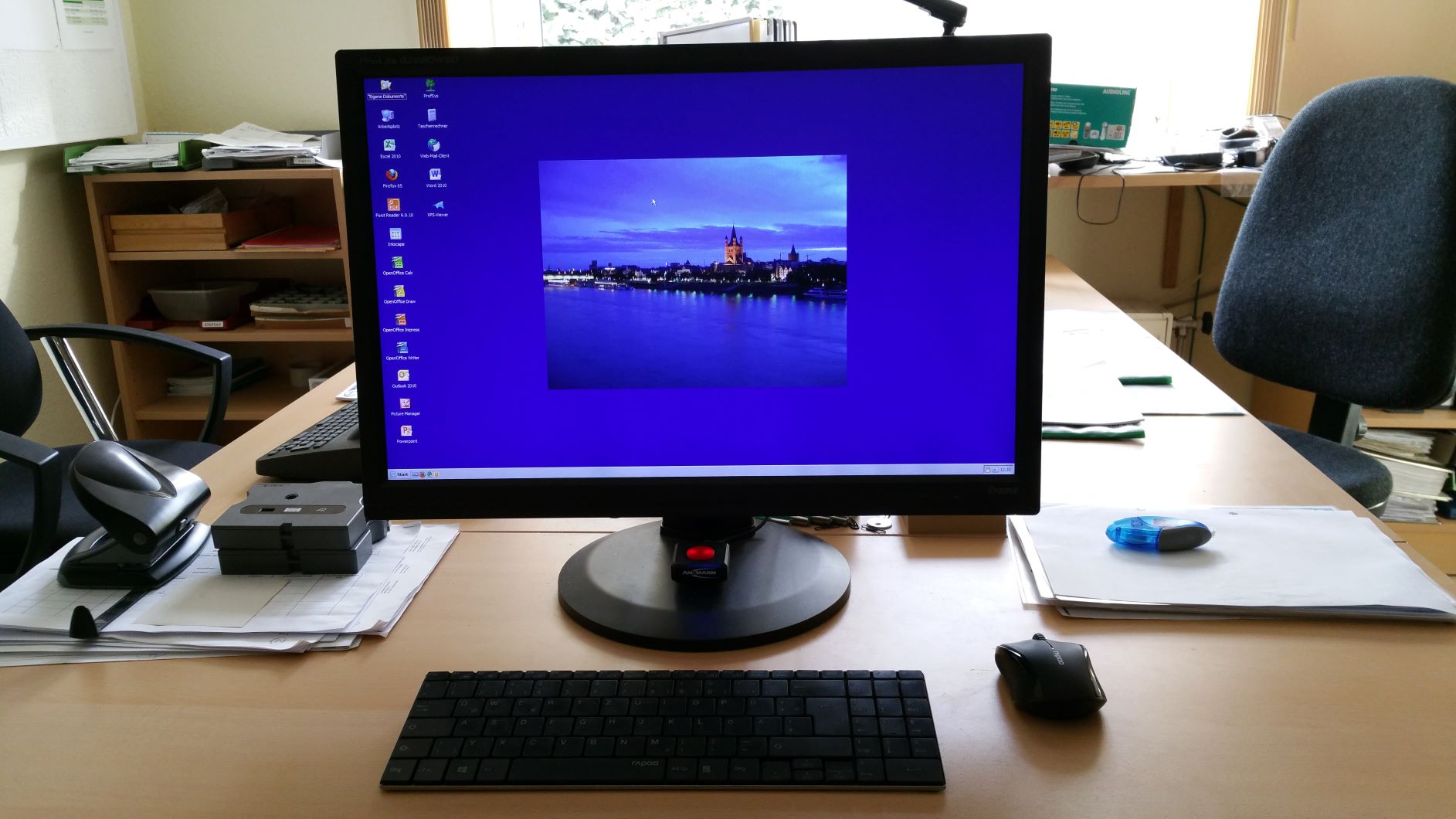

Here is a tip from me:
The problem with switching on and off I could solve with this product:
Ansmann AES3 Zero Watt - Smart PC - Power Saving Socket
https://www.amazon.de/dp/B00386RXW6/?sm ... th=1&psc=1
Only the monitor is on the desk and the power button is fixed on its base.
The monitor and the Raspberry are connected to the AES3.
After logging out of the terminal server, the monitor switches to standby mode. When the standby current of the monitor is reached, both devices are automatically completely disconnected from the socket after one minute. Then the devices do not consume any standby power.
Attached are 2 photos of such a computer workstation.

Great. It turns power off with monitor in standby and working Raspberry?fox-007 wrote: Mon Oct 21, 2019 1:33 pm After logging out of the terminal server, the monitor switches to standby mode. When the standby current of the monitor is reached, both devices are automatically completely disconnected from the socket after one minute. Then the devices do not consume any standby power.

Yes, the socket adapter AES3 can be taught. He learns how high the standby current of the monitor is and the current of the Raspberry. When this power is reached, it turns off the monitor and the Raspberry completely. I have both devices connected via a double table socket on the AES3. The Raspberry is automatically de-energized and then boots even when the power returns. Of course this also works with a desktop PC, TV, AV receiver and so on. In the bios of the PC you could set the behavior after the return of the power supply to "power on".
