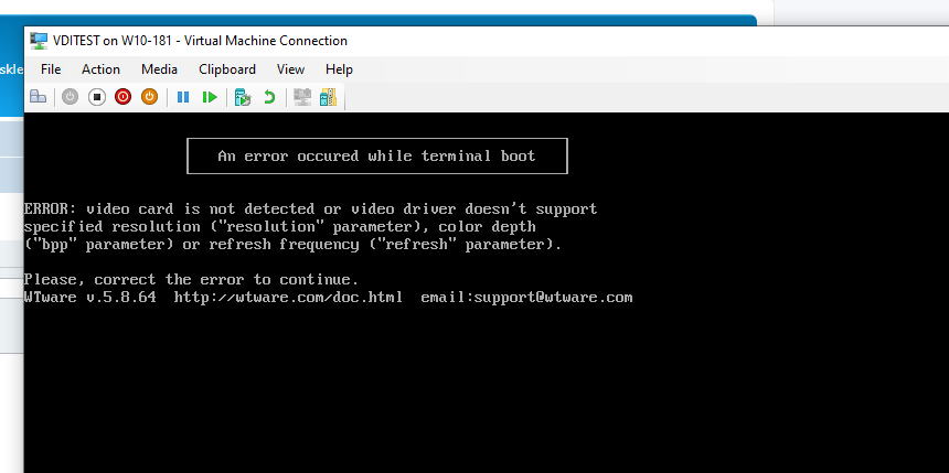

using a Windows 10 professional with Hyper-V role installed to test WTware.
machine boots onto the ISO image no probs.
no video parameters set in config.
getting an error with the video output on the machine. please see below:
have tried the video config wizard (DEL to setup and config video card.) running WTWare v.5.8.64
have attached the log file from the wtware server to give anybody the back end logs.
cheers in advance!
Lee

Re: Terminal testing with local hyper-V guest
Remove this line:
display=1440x900
From configs/config.wtc file on boot disk.
