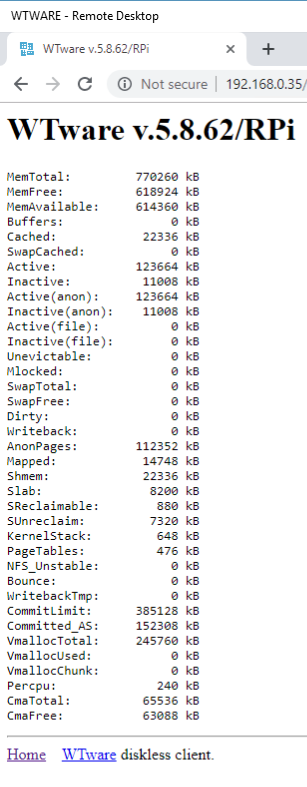

Hi team,
Does the current build of wtware (5.8.62) support the RPi4's 4GB ram? Seems it only knows about 770MB, if so will this change in next build?
Cheers.
Cheers.
- RPi4-4GB.PNG (104.11 KiB) Viewed 124635 times

We have no one to test now. It will run later.Fraal wrote: Wed Aug 07, 2019 8:11 am Does the current build of wtware (5.8.62) support the RPi4's 4GB ram?

PS: 5.8.64 should support the RPi4's 4GB ram.
