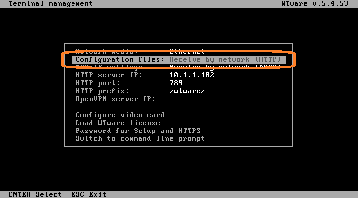

Hi Aka,
It's really not possible to connect PI3 in HTTP mode to download config from Wtware server ?
Because impossible to run with TFTP protocol in my Wlan

Please, try: http://pxe.ru/files/testing/201610240221.zip
nicodep
Posts: 27
Joined: Tue Aug 16, 2016 2:26 pm
Re: TFTP Problem with Wan MPLS Access
Post by nicodep »
Wonderfull
it works great !
Is this a test version ? or official soon ?
Great job Aka
Official 5.4.54 released.

Hello Aka,
Could include in the next version the option boot via HTTP in "Boot SD card" maker
This function run great but i need to manually modify this option on each PI3
Thk !
