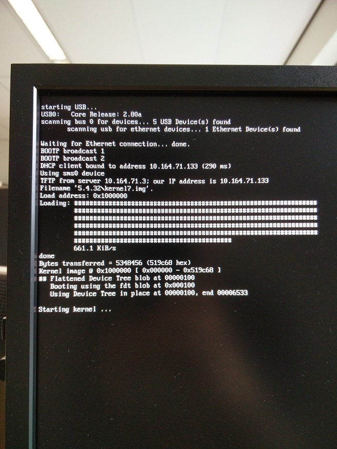

Dear all,
I updated from version 5.4.22 to the newest 5.4.32. I changed the 067 bootfile name in my DHCP server to the new version.
The raspberry pi 2 tries to boot, but stops on starting kernel. When the client is on starting kernel, and i click on "Press here to get log from terminal" it says at the bottem of the log: Failed to connec to <IP ADDRESS>.
When i change back the bootfile on the DHCP server to 5.4.22 it boots fine again.
Attached is a picture of the screen, and at the bottem of this post is the full log. Thank you in advance for your help.

10-39-24-267| [TFTP] Got RRQ, 48 bytes.
10-39-24-267| [TFTP] 00000000: 35 2e 34 2e 33 32 5c 6b 65 72 6e 65 6c 37 2e 69
10-39-24-267| [TFTP] 00000010: 6d 67 00 6f 63 74 65 74 00 74 69 6d 65 6f 75 74
10-39-24-267| [TFTP] 00000020: 00 35 00 62 6c 6b 73 69 7a 65 00 31 34 36 38 00
10-39-24-267| [TFTP] Request block size 1468, forced to 1460 (interface MTU 1500).
10-39-24-267| [TFTP] Requests file "5.4.32\kernel7.img". Tsize is not requested, blksize 1460 bytes.
10-39-24-267| [TFTP] Sending OASK (blksize 1460).
10-39-32-177| [TFTP] Transfer of file "5.4.32\kernel7.img" completed.
10-39-32-177| [TFTP] Connection closed.
10-47-05-029| [TFTP] Got RRQ, 48 bytes.
10-47-05-029| [TFTP] 00000000: 35 2e 34 2e 33 32 5c 6b 65 72 6e 65 6c 37 2e 69
10-47-05-029| [TFTP] 00000010: 6d 67 00 6f 63 74 65 74 00 74 69 6d 65 6f 75 74
10-47-05-029| [TFTP] 00000020: 00 35 00 62 6c 6b 73 69 7a 65 00 31 34 36 38 00
10-47-05-029| [TFTP] Request block size 1468, forced to 1460 (interface MTU 1500).
10-47-05-045| [TFTP] Requests file "5.4.32\kernel7.img". Tsize is not requested, blksize 1460 bytes.
10-47-05-045| [TFTP] Sending OASK (blksize 1460).
10-47-12-931| [TFTP] Transfer of file "5.4.32\kernel7.img" completed.
10-47-12-931| [TFTP] Connection closed.
10-49-29-936| [TFTP] Got RRQ, 48 bytes.
10-49-29-936| [TFTP] 00000000: 35 2e 34 2e 33 32 5c 6b 65 72 6e 65 6c 37 2e 69
10-49-29-936| [TFTP] 00000010: 6d 67 00 6f 63 74 65 74 00 74 69 6d 65 6f 75 74
10-49-29-936| [TFTP] 00000020: 00 35 00 62 6c 6b 73 69 7a 65 00 31 34 36 38 00
10-49-29-936| [TFTP] Request block size 1468, forced to 1460 (interface MTU 1500).
10-49-29-936| [TFTP] Requests file "5.4.32\kernel7.img". Tsize is not requested, blksize 1460 bytes.
10-49-29-936| [TFTP] Sending OASK (blksize 1460).
10-49-32-135| [TFTP] Timeout occured while transfer "5.4.32\kernel7.img".
10-49-32-135| [TFTP] Resend block 91.
10-49-39-858| [TFTP] Transfer of file "5.4.32\kernel7.img" completed.
10-49-39-858| [TFTP] Connection closed.
10-50-06-270| [wtc.exe] Failed to connect to 10.164.71.133:779.
10-50-15-078| [wtc.exe] Failed to connect to 10.164.71.133:779.
10-50-27-579| [wtc.exe] Failed to connect to 10.164.71.133:779.
10-50-51-205| [wtc.exe] Failed to connect to 10.164.71.133:779.
10-56-53-664| [TFTP] Got RRQ, 48 bytes.
10-56-53-680| [TFTP] 00000000: 35 2e 34 2e 33 32 5c 6b 65 72 6e 65 6c 37 2e 69
10-56-53-680| [TFTP] 00000010: 6d 67 00 6f 63 74 65 74 00 74 69 6d 65 6f 75 74
10-56-53-680| [TFTP] 00000020: 00 35 00 62 6c 6b 73 69 7a 65 00 31 34 36 38 00
10-56-53-680| [TFTP] Request block size 1468, forced to 1460 (interface MTU 1500).
10-56-53-680| [TFTP] Requests file "5.4.32\kernel7.img". Tsize is not requested, blksize 1460 bytes.
10-56-53-680| [TFTP] Sending OASK (blksize 1460).
10-57-01-558| [TFTP] Transfer of file "5.4.32\kernel7.img" completed.
10-57-01-558| [TFTP] Connection closed.
Re: Not booting after update
Please, try to SD card with new WTware version. Will it help?
silfermoon
Posts: 5
Joined: Wed Mar 16, 2016 11:46 am
Post by silfermoon »
I formatted my SD card and copied the new version. Now it boots. I wanted to ask because it kind of defeats the purpose of having a tftp server.
(as a side note, it seems booting is way slower in comparison to version 5.4.22. It hangs on please wait for about 15 seconds, before with the old version it continued instantly.)
silfermoon wrote:I formatted my SD card and copied the new version. Now it boots. I wanted to ask because it kind of defeats the purpose of having a tftp server.
I agree. Raspberry developers update firmware (it's files on SD) and Linux kernel, and do not worry about new kernel and old firmware compatibility.
silfermoon wrote:(as a side note, it seems booting is way slower in comparison to version 5.4.22. It hangs on please wait for about 15 seconds, before with the old version it continued instantly.)
Has time from turning power on until "Windows login" screen changed significantly?
