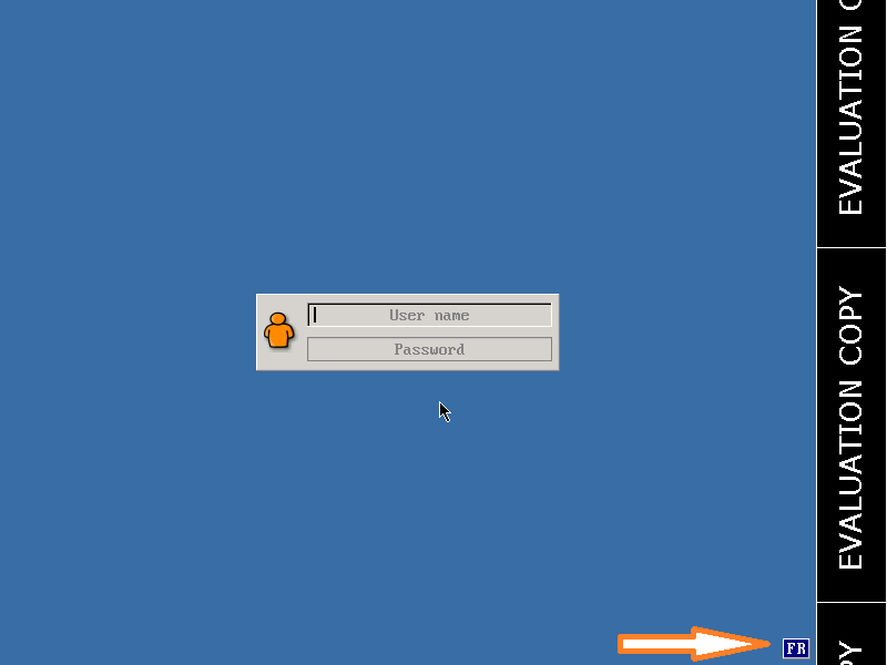

Re: keyboard language Problem
Posted: Fri Mar 07, 2014 12:00 am
Ups. I found one bug.
Please, put the line
language=fr,default
in the very beginning of the config file.
You should get blue square with FR letters in right bottom corner.
Posted: Fri Mar 07, 2014 12:02 pm
by gourdon
Ho yes, sorry, i confused between language=fr and keyboard=fr
Now it works fine, but there is no FR letters in the blue square in right bottom corner.
Thank you very much for your reactivity
Regards.
JMG
Posted: Fri Mar 07, 2014 1:49 pm
FR letters:
You did not see it, but keyboard works as AZERTY instead of QWERTY? Funny. Please, boot up the terminal, press left top key (q in qwerty, a in azerty) and send me whole log to aka@pxe.ru
Thank you.
