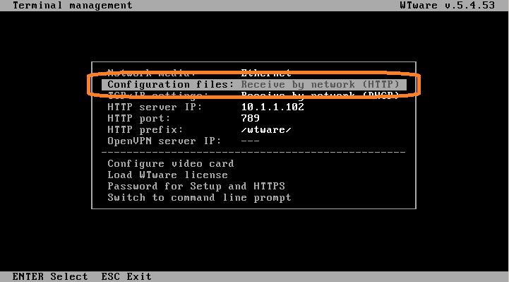

Could include in the next version the option boot via HTTP in "Boot SD card" maker
This function run great but i need to manually modify this option on each PI3
Thk !

nicodep wrote:Could include in the next version the option boot via HTTP in "Boot SD card" maker
Hi Aka, just to remember this tips for your next version !
Thk
Re: TFTP Problem with Wan MPLS Access
Posted: Fri Mar 03, 2017 12:36 pm
We'll do it, thanks.
