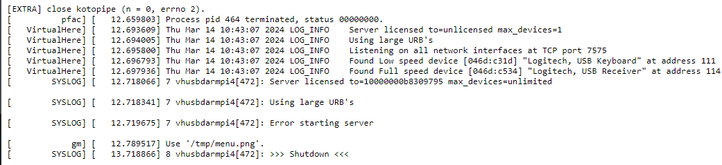

Here is the Wtware Log screenshot:

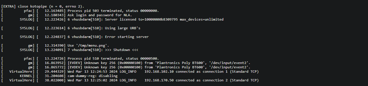

The screenshot:
Kind regards,
Keanu
