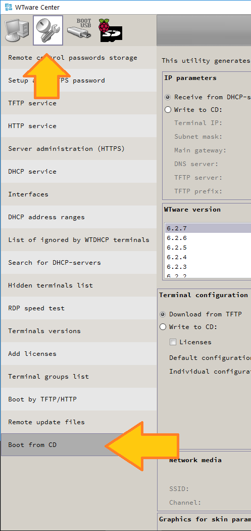

Boot CD should boot if made as Boot CD. Not Boot USB.
Here:
Here:
- Untitled.png (44.06 KiB) Viewed 58789 times

Thanks for the reply.
I said:
"If I use the BOOT SD option, a bootable SD card is created and it boots without any issues."
I meant that if I tried the BOOT USB option, it would create a Bootable SD card that would USB boot in each of my 3 test computers.
My problem is creating a CD with BOOT from CD.
