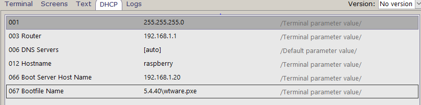

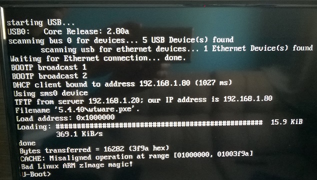

I'm trying to use a RB Pi 2 to boot through network, but it is not working, I setup DHCP, TFTP on WTware Center, it works, gets the IP address, find the TFTP and it downloads the wtware.pxe file, but it shows the message "CACHE: Misaligned operation at range [01000000, 01003f9a] Bad LINUX ARM zImage magic!"
What's wrong?
PS: If I boot the system through the SD card it works fine! I'm able to connect to terminal server, the problem just happens through PXE boot.

Do not write "5.4.40\wtware.pxe". Doubleclick on 067 line and check server autodetection.
If you reeeealy want to specify value, put "5.4.40\kernel7.img" here.
