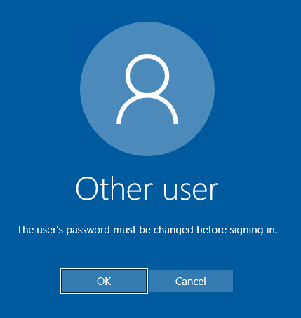

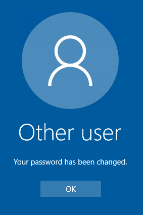

Why password change not functional in 2) ? Here is my 2016 without NLA after ask_password=on:
I press OK, and:

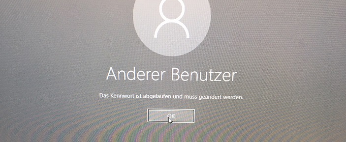

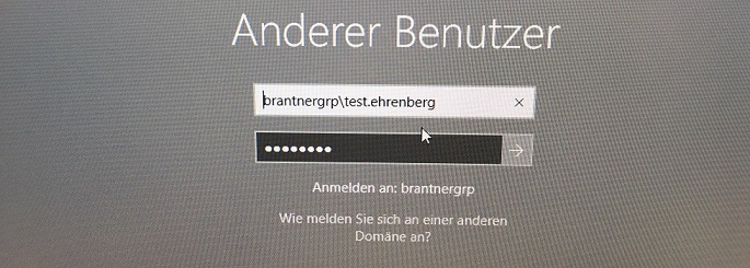

ok, think there is a strange behaviour - tried it on our 2016 test rds server without a broker.
after login, the user receives the message to change password -> hit ok -> and then the loginscreen in attachment2 appears - but its not possible to login
maybe its a CredSSP thing - going to try a few things

- 1.JPG (157.75 KiB) Viewed 22022 times
- 2.JPG (77 KiB) Viewed 22022 times
- 3.JPG (84.07 KiB) Viewed 22022 times

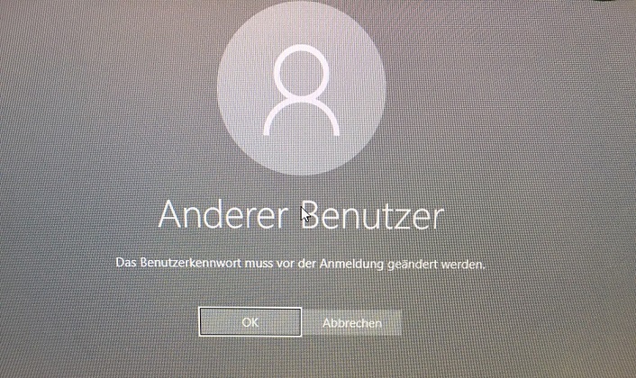

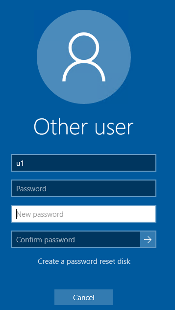

tried to change credssp to rdp - but also with no luck.
do you have any special configuration?
Update: I only receive the dialog, if I try to login to testserver via windows 10 notebook and mstsc, than the dialog appears and I'm able to change the password.
If I try to login via wtware on raspberry, the dialog won't appear
