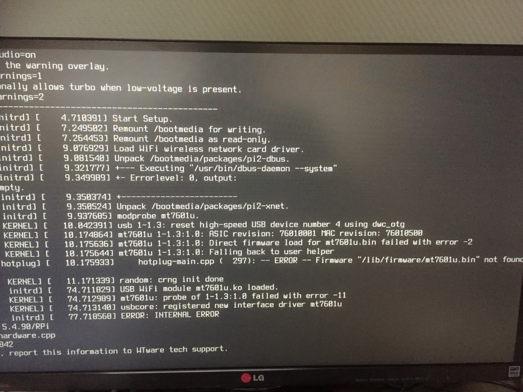

Now I get this (attached picture)
This is appening when starting wifi drivers.
Regards,
Re: Dlink DWA 127 USB Wifi Antenna compatible?
Ups...
From command line type:
cat /tmp/all.log
Press Enter.
Take a photo.
Press Shift-PageUp.
Photo.
Repeat "Press Shift-PageUp. Photo." three times.

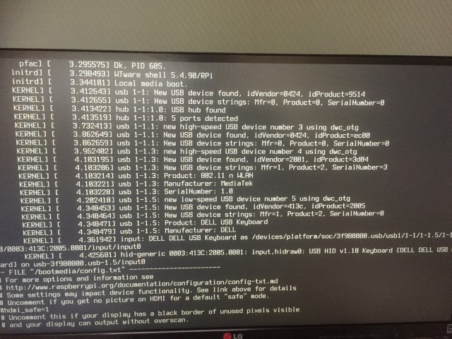

seto
Posts: 6
Joined: Thu Feb 23, 2017 4:04 pm
Post by seto »
I'm using 5.4.90, and still getting trouble. You can see in attached file.
Thanks for your help.
