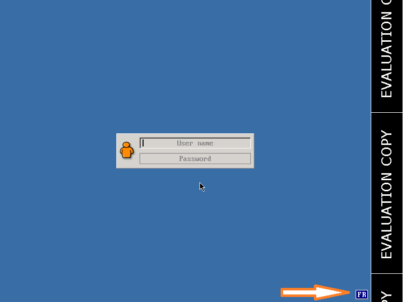

Ups. I found one bug.
Please, put the line
in the very beginning of the config file.
You should get blue square with FR letters in right bottom corner.
language=fr,default

Re: keyboard language Problem
FR letters:
You did not see it, but keyboard works as AZERTY instead of QWERTY? Funny. Please, boot up the terminal, press left top key (q in qwerty, a in azerty) and send me whole log to aka@pxe.ru
