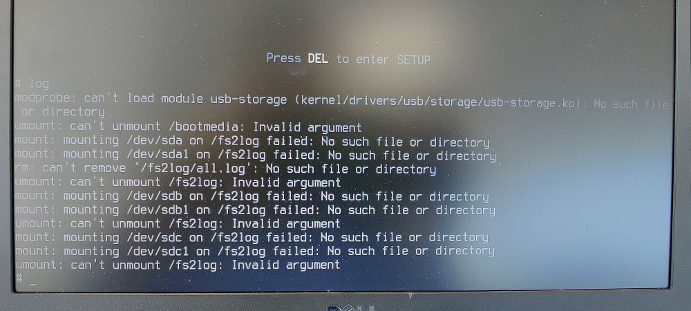

Additional information from all.log:
[initrd] bootWay.cpp (132): -- ERROR -- Failed to mount /bootmedia
[initrd] bootWay.cpp (198): -- ERROR -- INTERAL ERROR. Please, contact WTware tech support.
[initrd] bootWay.cpp (251): -- ERROR -- INTERAL ERROR. Please, contact WTware tech support.

aka wrote: Thu Apr 22, 2021 7:07 pmShow me FULL all.log
I want to, but then I have to take a lot of photos.
It goes to CLI after the error message, web interface does not work.
I used less /tmp/all.log to view the log file.
Re: UEFI Error: Failed to mount boot media
https://wtware.com/logs.html
Take USB flash, common, small capacity, without passwords, without encryption.
Format it. File system must be only fat32, others won't work.
Connect newly fat32 formatted flash to terminal.
From terminal command line run command:
log
Wait for half a minute. On the screen you may see errors, it's ok. Make photo of the screen and attach photo to e-mail.
Eject USB flash. Connect to windows computer. On this flash should be file all.log.

Unfortunately that also doesn't work
